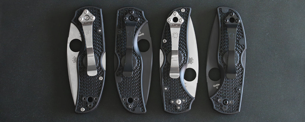

4 knives showing the pocket clip set to different carry options.

When Spyderco co-founder Sal Glesser designed our first folding knife, the Worker™ model, he incorporated a clip to allow it to ride comfortably and conveniently at the top of the pocket. Inspired by a unique frog-shaped keychain he had, this feature kept the knife instantly accessible and freed the rest of the pocket to carry other items. It also complemented the one-hand-opening convenience of our Trademark Round Hole™ to not only define the form of Spyderco’s revolutionary CLIPIT® models but set the standard for all modern folding knives.
Since the introduction of the Worker in 1981, Spyderco knives—and our clip designs—have evolved considerably. While early models offered only a single carry position, later designs incorporated the option of tip-up or tip-down carry. In 1997, we introduced a reversible “barrel-bolt” clip design, which is easily configurable for left-or-right-side tip-up carry. Today, many of our designs offer the versatility of a four-position clip, which supports left- or right-side, tip-up or tip-down carry. In fact, we are not only the pioneers of clip carry, but consistently offer more clip-carry options than any other manufacturer.
To take full advantage of the versatility of our clip designs, it helps to be familiar with the proper methods of removing, installing, and configuring the various styles of clips we currently use, as well as those used on older Spyderco knives. This article is intended to give you that knowledge and guide you through the process.
