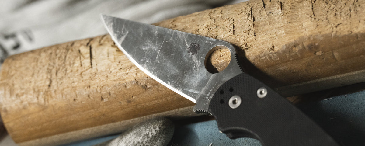

A dirty knife blade resting on a rough piece of wood.
