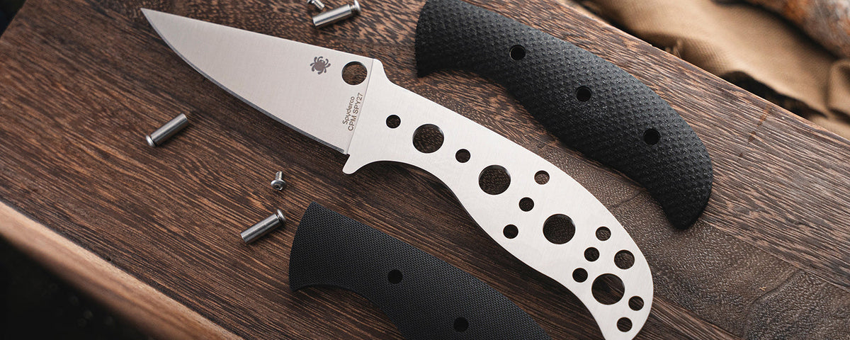

The Spyderco Mule Team Project is a remarkable program centered around a single, identical fixed-blade knife pattern. Every limited-edition production run of the Mule Team blade showcases a different blade steel but offers it in the exact same physical form. Since the steel is the only variable, the Mule Team Project allows steel-obsessed knife enthusiasts an unprecedented opportunity to test and evaluate different blade materials using the same identical design platform.
Customize Your Mule Team Knife
Mule Team blades are purposely sold without handles or sheaths to give our customers the freedom to finish them to suit their personal preferences. The easiest way to do this is with the pre-made handle scales and sheaths available through Spyderco.com. Our scale kit features contoured, 3-D-machined G-10 scales with a high-traction checkered texture. It comes with stainless steel mounting hardware and can be easily installed in a matter of minutes with two T-8 Torx® wrenches. Once the scales are in place, the finished knife fits perfectly into our aftermarket Boltaron® or leather sheaths.
If you’re more adventuresome and skilled at working with your hands, you can fashion your own Mule Team handles. Many aspiring knifemakers consider Mule Team blades the foundation of the ultimate “kit” knife. All blades come pre-drilled with a variety of hole sizes and locations to accept pins, cutler’s bolts, and tubing, allowing hobbyist knifemakers to attach their preferred handle materials any way they want and finish them to shape. Often, they make their own leather or Kydex® sheaths as well.
