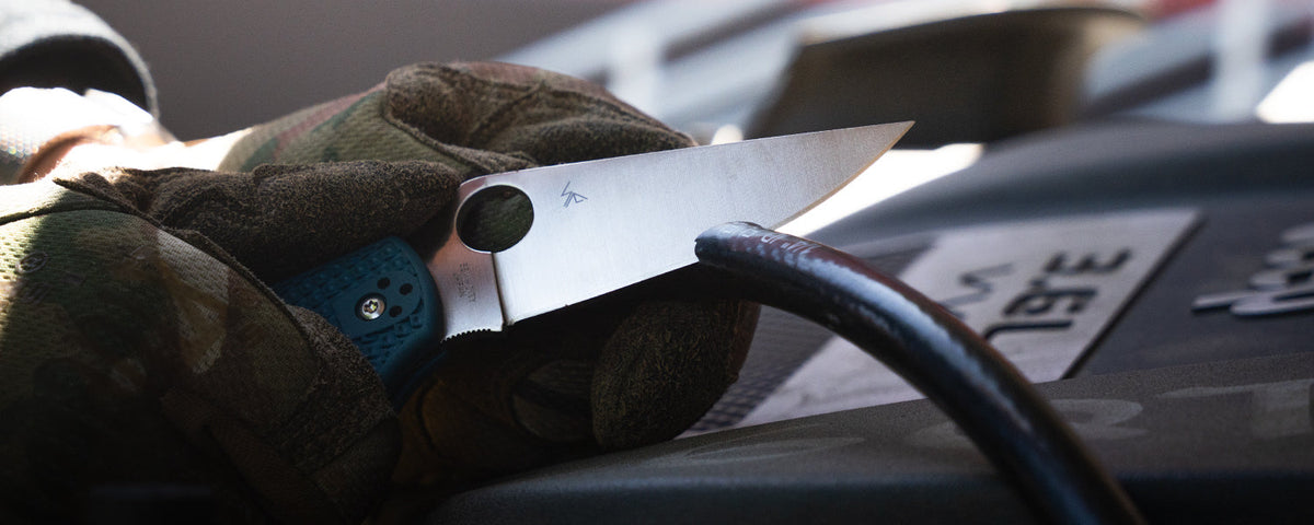

A mechanic using a knife to slice a line.
