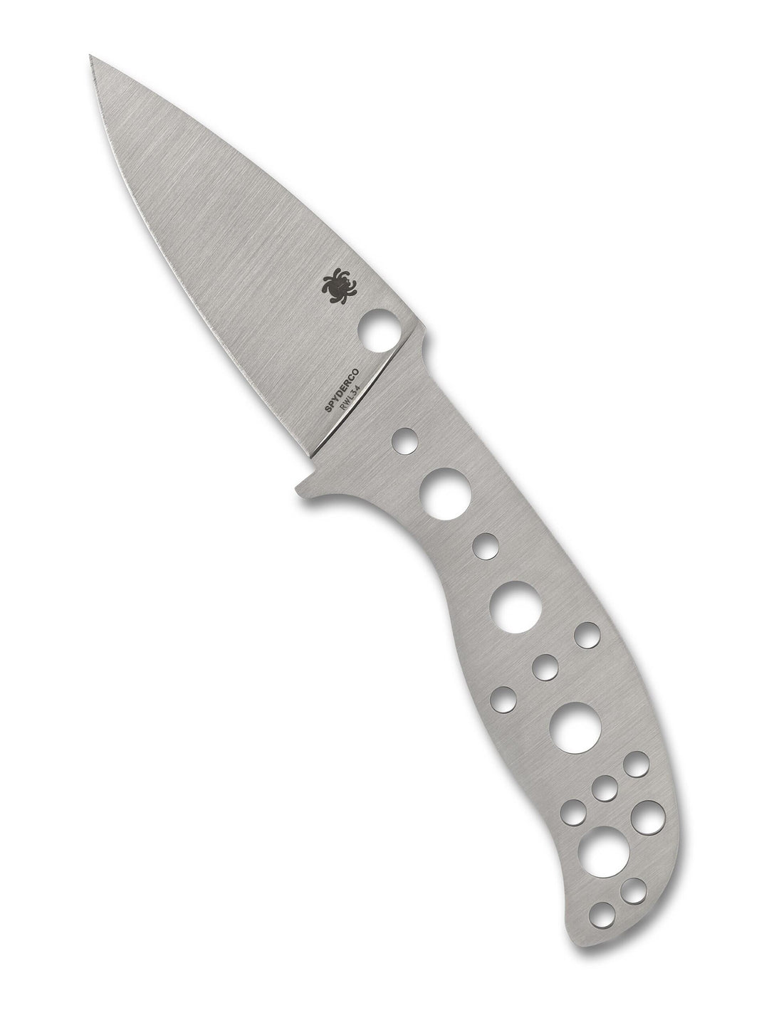

Spyderco’s Mule Team™ Series is an ongoing project that enables steel-obsessed knife enthusiasts to test different blade materials using the same exact fixed-blade design platform. Sold without handles or sheaths, Mule Team blades are also ideal for aspiring knifemakers and hobbyists.
This expression of the Mule Team concept features RWL 34, a "rapidly solidified powder" (RSP) martensitic stainless steel made by the renowned Swedish firm Damasteel®. RWL 34 is a variation of the 420 martensitic stainless family that contains 14% chromium, as well as molybdenum and vanadium for improved corrosion resistance, hardness, and strength. The performance of these alloys is further enhanced by the RSP process, which involves using high-pressure nitrogen gas to force the molten steel through a nozzle. Just as in the CPM process used by Crucible, this creates a spray of small spherical droplets that rapidly solidify into powder particles, drastically reducing the segregation, or settling, of the alloys in the steel to produce an extremely fine, uniform carbide structure.
RWL 34 has long been a favorite of custom knifemakers—particularly Canadian maker Brian Tighe, designer of the Tighe Stick—because of its high-performance characteristics and the fact that it is capable of taking an extremely high polish. However, it has not been used in the production of factory-made knives because it was not available in large sheets. Recent improvements in the availability of the material have changed that situation, so Spyderco quickly seized the opportunity to incorporate RWL 34 into our Mule Team Project.
RWL 34's alloy composition is as follows: Carbon - 1.05%, Manganese - 0.50%, Silicon - 0.50%, Chromium - 14.0%, Molybdenum - 4.00%, Vanadium - 0.20%. This advanced alloy mix makes it a very close equivalent of 154 CM and ATS-34 stainless steels, but since it has the additional advantages offered by the RSP process, it is actually closest to CPM 154—Crucible’s particle metallurgy version of 154 CM—with the addition of several trace elements.
