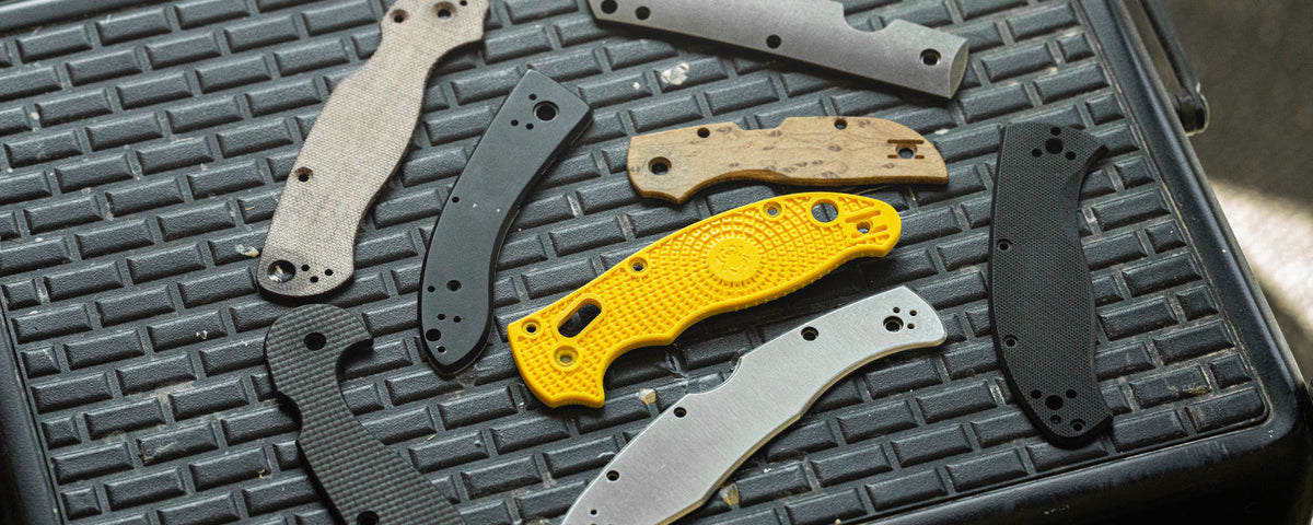

A collection of knife scales made from different materials.
Knife Handle Materials: Understanding Your Options

While the blade is unquestionably the soul of a knife, the design and construction of its handle are every bit as important in defining its function as a cutting tool. Historically, the materials used to craft knife handles have had a profound effect on their durability, user friendliness, and visual appeal. Exotic and highly sophisticated materials can further elevate a knife’s aesthetics, uniqueness, and value. Well-educated knife enthusiasts therefore owe it to themselves to understand the intricacies of knife handle materials and the myriad options currently available.
During our 50-year history, Spyderco has explored a wide variety of handle materials in the production of our knives. That experience has given us some hard-won wisdom when it comes to choosing materials best-suited for specific knife designs and applications. In addition to cost, we also have to consider factors such as machinability, strength, dimensional stability, vulnerability to chipping and cracking, water and chemical resistance, resistance to color fading and wear, consistency, and long-term availability. With all those complex factors in mind, here’s a brief overview of some of our most popular handle materials and the advantages and disadvantages of each.
